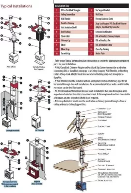

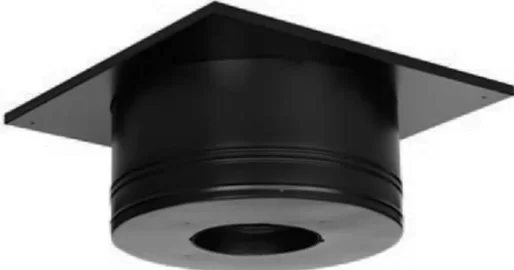

Ok then, for going through the ceiling use something like the picture on the right below. More designs are at the following URL (hot links on the side):
(broken link removed)
But basically you will want to accomplish one of the types of configurations in the picture to the left below in order to pass through the ceiling/attic/roof of your house. You can see this picture if you click on the "more images" link in the photo of the page above.

Thanks again for even more info...
