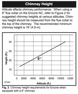

I just noticed your altitude Kosmik. I think that's what you are fighting. At sea level this probably wouldn't be an issue. The stack needs to be taller to draft well at high altitudes. If you want to go 6" all the way, by all means do it. It should improve operation. And if you can add a couple more feet, even better.

VC has always included an altitude chart with their stoves. Perhaps this will be helpful to Kosmik. Note how it goes from recommending 16' at sea level to about 24' at 7200ft.
