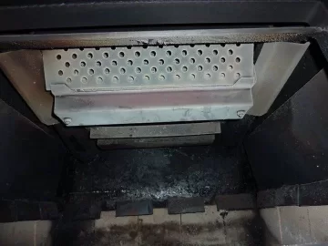

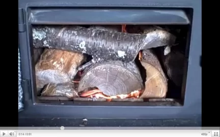

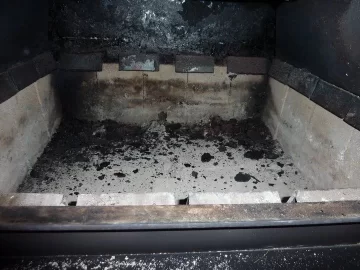

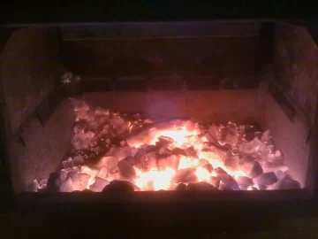

I don't yet own one so here it goes:
Is it possible instead of loading it fully and turning the dial way low, would it be better to just load it less-than-full (say half) and turn the dial a tad higher so the wood burns better and not have the cat working so hard to clean up so much smoke? Am I thinking this correctly? Also, would the burn time be lower in the second situation? if so, would I get 8-10 hrs vs 16? This way I think we could get a lower heat output on not-so-cold days, correct?
Either way, the area I will be heating is over 2400 sq.ft. and the family room the stove would be in has an 18' flat ceiling and a large wall of windows in Northern Illinois climate; that's why I'm thinking I may need the king. I found a dealer (300 mi. away) that said I could take home the Princess and try it out in my house, and if I feel it's not suitable, he would swap it for a King (I would pay the price difference of course).
But I looked at a stuffed Princess picture below and I think that firebox is just very small.
In the other picture below can anyone tell if that is an empty King or Princess firebox?
Also, would it be advantageous to line the firebrick all the way up, instead of just halfway up?
I think that must be a Princess.
