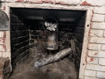

This forum has been great in trying to help me replace my hearthstone homestead. I've had an installer out to look at my fireplace opening and flue setup.
I can't fit any decent size insert including the Blaze King princess. The only two freestanding stoves with fireboxes close to 2 cubic feet are the Castleton and Nova 2. I'm leaning Castleton due concerns about lack of air control and burn times in the Nova 2.
Anyone have a different opinion between the 2 models? I'm not in love with either but I need something for this winter.

I would love to get any of those Jotuls but the rear flue exits are too tall. I'm limited to 21.5" or less to center of rear flue exit.

Yeah I don't really like any of my options. Just figured out that the Castleton will stick too far out in front of the hearth. I may be at the point where I'm going to price what it would cost for a mason to make my fireplace opening bigger so I could fit a stove with a taller rear flue entry
Can't fit one of any decent size. I had an installer come out to measure everything.
Just for yucks, can you provide the full dimensions, front and back including depth, top and bottom? There may be options that they don't carry.

See the attached pic. The width is just under 26" up front and 23 3/4 across the back. Depth is 17.5", Height is 25 3/4" but it slopes down pretty steeply towards the back.

What is the height at the very back?
What is the width at 13" deep? It looks like the Iron Strike S160 insert would fit, even if it took a little brick shaving with a grinder.

I take that to mean from the front of the opening to the rear of the opening? No? L x W x H in this case, depth is the length?
Width at the front is 26" and width at the rear is 23 3/4". The height in the front of the opening is 25 3/4" and at the rear (back) the height is 13 1/2".
The sides slope in and the top slopes down.
I could be wrong. I'm married and I'm wrong a lot more than I thought possible.
Look at the picture, count the 2.75" high bricks. That's more like 23" H at the rear.
This is correct "The sides slope in and the top slopes down."
The back height is only 13.5" until it starts to slope up towards the front.

I'm with begreen. I count 8 courses of brick at the rear of the opening. That's over 22 inches when you include the mortar. Please re-measure the opening again. Unless those bricks aren't standard thickness, it has to be more than 13 1/2.
When I get home I'll try and get a better picture but at 13.5" is starts to slope
Ok, that's different. I can see the slope. The important dimension is what is the depth at around 19" to 21". That's a common insert height.
