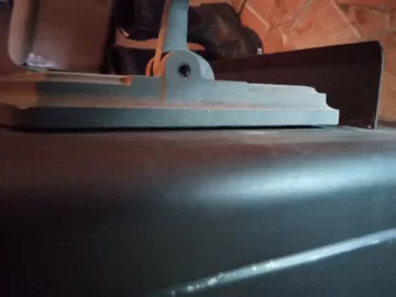

I have read a lot of the 6041 threads/info thanks to all those that have posted the helpful info. I am just good enough at most things to make me dangerous and I cannot leave anything alone. I do not have FAK, I do not have holes plugged behind firebrick(plan to this week). Stove is on auto everything except room fan. I agree with getting me BTUS. I only burn Somerset's in er and have for about 4-5 years now. It seems this year on HR 3 me burn pot overloads and fills burn pot. I cannot seem to get into adjust the feed rate. I have HR1-5. 2 seems to be the sweet spot. I did notice today that there is a tiny air gap on the latch side of door. Door gasket is new this year and seemed to close air tight when I changed it. So I guess long way to this question(s) is can door be adjusted? Do not think I warped it.
Any tricks to get into feed rate adjustment. I have sat here for a long time hitting the two buttons in as many different ways as possible and just can't seem to get into that menu.
I plan to replace or maybe double gasket?
Thanks
Stove originally came flat gasket usually replace with 5/8 round gasket. Door is not adjustable and you would really have to have a hot fire to warp.

I should have asked can you see flame/light through the crack in the door? The left side (latch side) does not fit flush the top of my door is around 1/8 inch from flush and that widens to around 3/16 on the bottom but the door is sealed because of the gasket not the cast metal on the door.
johneh
Dec 19, 2009
4,758
Eastern Ontario
Have you done the dollar bill teat on the door?
