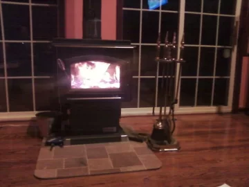

Hello,
First post here and new wood stove owner.
I recently bought and installed a Vogelzang Highlander wood stove (price paid $799). While the stove provides plenty of heat for the area I'm trying to heat, I'm not happy with the unit at all. I've had several issues with it
such as a faulty blower switch, broken air control lever, loose door hinges, etc. The manufacturer has already given me the authorization to take the unit back to the store. So now it's time to shop for a replacement, but this
time I will take my time, do a lot more research, and with your help I hope to find a unit that we can be happy with.
The house is about 3,000 sq.ft., but I'm just looking for a unit to supplement the furnace, I'm not looking to heat the house by wood only, since there is probably not a free-standing unit big enough for that. The Highlander is in the family room, 20x24 and with 18ft. ceiling, and open to the kitchen, hallway and dining room. So I think I need a unit that is listed for at least 2,000 sq.ft. The highlander is listed as able to heat up to 1500 sq.ft.
Another issue to consider is the firebox size; I've had to cut down in half, most of the logs in the 1 face cord I've used up in the past 3 weeks.
Vogelzang claims the Highlander is able to achieve a burn time of 6-8 hours, which is BOGUS. I don't see how anyone will be able to achieve that, since the most time I've ever been able to burn on a single load of wood is 2-2.5 hrs in the lowest setting. I know what you're thinking and NO, it's not the wood. I've used various pieces from different suppliers and the burn time has been limited to 2-2.5 hrs the most.
Any suggestions would be greatly appreciated, but please make your suggestions based on experience, and not based on guesses or hunches, just to keep this post relevant and useful for myself and future stove owners alike.
I have seen several larger stoves for sale, such as the Drolet HT2000 (95,000BTU), Sahara(85,000BTU), or the Napoleon Timberwolf (85,000BTU), just to name a few I've looked at online.
The Vogelzang website lists a "Performer" model, but I'd like to stay away from that brand because of the bad experience I've had with the Highlander and from what I've looked at, it seems cheaply made and low quality.
So please let me know what you think.
Thank You in advance,
John
  • [Hearth.com] Need help choosing a better stove

And regarding the stove size, with lots of glass in your home -- as is shown in the picture in the original post, get the largest stove possible.
And regarding those nice hardwood floors, the existing hearthpad looks undersized, unless you or sig other likes to see "distressed" wood - those floors will be tested with sparks, wood drops etc.
