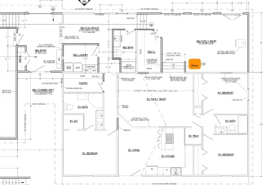

We will likely put this a corner of the new Fam Room next to the half stairs that leads into the old fam room which has a 5x7 opening. So a N/S loading deeper stove might fit the space better. Combined common area is about 1100sqft.

Dealer makes it sound like maintenance is minimal. I do like the look of the GM 80, big glass. But concerned the 3.1cu ft firebox may be too large? Overall living space is 2900. The room it will be in is 480sqft but an archway that leads to the kitchen/dining so that combined area (fam/kit/dining) is about 1100sqft with 9-10ft vaulted ceilings and skylights. . Then the bedrooms etc come off of that? GM60 or GM 80? We get Midwest Cold, mid MO, but not North.
