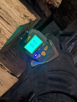

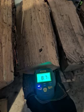

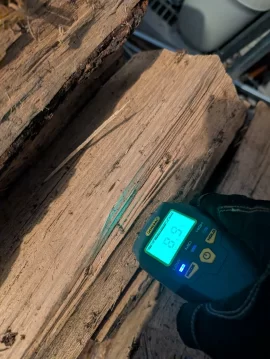

You say some of your wood is 8%, thats a very difficult number to reach on Long Island. I'm assuming you have a moisture meter to check it, can you tell us your process in checking your wood. It may very well be below 20% but I'm quite skeptical it will reach 8% in our coastal region.
Reactions: bigealta
Hey sure! Yes I use a moisture meter and usually stick the pins as hard as I can in both ends and somewhere in the middle and just kinda get an average of each before I throw it in the wheelbarrow. If it's over 16ish I throw it back on an empty rack for next season.
They're most often closer to about 12% as a rough average of a season, one year an entire chord came in over 20 it threw us off rhythm. This year I think we just got a good bunch I've got mostly around 9ish, occasionally a 12 in there, been very easy to light up.
Happy for tips though let me know! Maybe I'm doing it totally wrong! 😅

Water in wood freezes. MM don't work with frozen wood. Bring a piece indoors. Let sit 24 hours, but not in stove room. Split the wood and pushing pins with the grain, take the reading from the fresh split face.

I see your gloves, the splits must be at room temperature, say 70, for an accurate measurement. And you need to stick the probes into a freshly split face. Your wood is wetter than you think but maybe still okay.

Ah good tips thanks very much! These have been indoors a few weeks (I just use these gloves for everything cause the wood's dirty 😅), I'll try it out next time with a fresh split and see 👍

As others have said you need to take a warm piece outside, grab an ax, resplit it and check the middle of the freshly split edge. Don't worry about the ends. If your buying your firewood it generally needs at minimum a full summer to season before it is ready to burn. Some species like oak which we have a lot of on LI can take 2-3 years after being split to be ready to burn.
