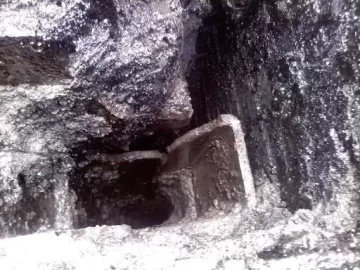

Guy called the shop, said he needed a liner. I saw the chimney and told him to tear it down. Whaddya you guys think!?

Just shove some 26 ga black stove pipe down there and use dryer vent to make the turn at the bottom thru the thimble. Shove newspaper around the top because insulated liners are better.
I've looked down hundreds of chimneys...that is in the top 10 for sure..maybe top 5 of bad
....uh...yeah
looks like a simple scrubing ought to do...scrubing yourself up after ripping that thing to pieces.
I wonder how people can neglect any part of the house but this one in particular. sorry for the guy as now he has to build a new one. a hair bit more expensive and involved than a liner..
Is that a cave?
Yikes! What did he say when you told him to tear it down?
I am not sure what the picture shows and what it is telling you guys about the history of that chimney. I think I see the remains of a ceramic liner with some broken/missing pieces, some missing bricks in the chimney surrounding the liner, and a lot of black, indicating fires have happened. Is that what I see? Why couldn't this chimney be lined and the bricks at the top replaced?

if you hadn't told us, I would have guessed it was a well, or a mine shaft....with build up that thick it might actually be worth it to mine it....looks like you could end up with a pretty good amount of burnable material for a coal power plant.

Egads . . . glad he came to you . . . this is a bad chimney fire or structure fire in the making to be sure.
How did he come to the conclusion that he needed a liner?
he argued with me about the need to do so...
he wanted to install a new woodstove, and his local sweep told him he had "a couple cracks" in the flue tiles towards the top of the chimney.

actually, the rest of the house is pretty nice.... this is an exterior chimney, pretty old... its on an old farmhouse style Cape by the ocean, completely redone inside, top shelf all the way.
Understatement of the century!
First and foremost, function over form. The rest of the house got plenty of attention, but the part that can turn it all to ashes is a sticking point.
