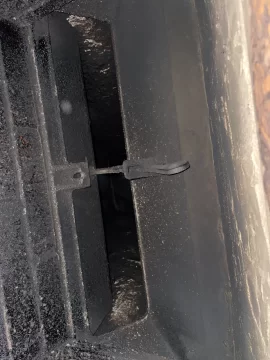

  • [Hearth.com] Chimney liner for Kuma Cascade

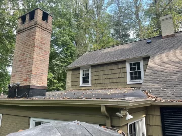

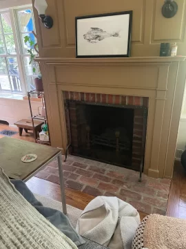

Whether an insulated liner is needed depends of the chimney clearance from any combustibles. This looks like an exterior wall fireplace. If so, it must have 1" clearances from any combustibles in order to have an uninsulated liner. This doesn't seem to be the case here.
How well does the fireplace work? Is there any smoke rollout at times? I ask because the house configuration with this fireplace in a one story addition often is a problem for drafting. If it is an issue, an insulated liner will help improve draft a bit.
Note, to help fitting, the insulated liner can be slightly ovalized by a professional and then left round at the insert connection end.

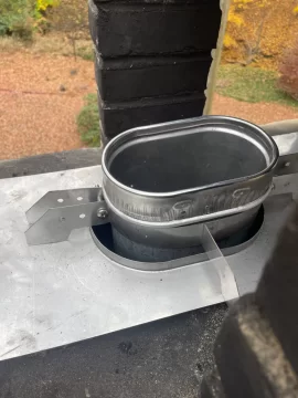

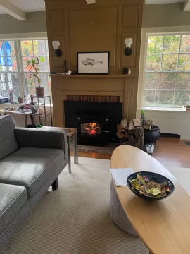

I bought the duraliner oval rigid pipe and an oval cap but I don't see an oval slip collar. Has anyone used this stuff with an oval cap? It looks like the install will be super straight forward.
I got it from efireplace and while the techs are great the rest of the experience has not been great. One package lost, some parts missing, and to make a warranty claim for the missing parts you have to fill out an online form and then wait for them to get back to you.
After much planning and test fitting the hardest part was getting the stove out of my truck and in the house.

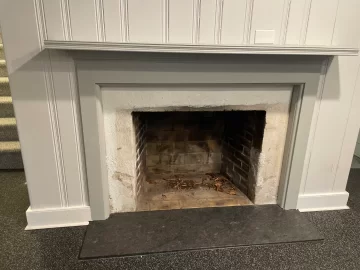

If duraliner had better quality control this would be a 100% go -to option for me again. But their QC leaves a bit to be desired, that said it all went in easy after some test fitting, drilling when the pre drilled holes don’t line up and a few more mods.

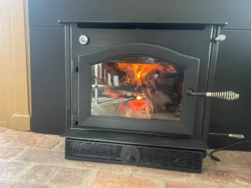

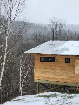

The draw is great and the performance of the Kuma has vastly exceeded my expectations. Installed the chimney in my sauna today, standing seam tomorrow, and will tackle the Woodstock soapstone ideal steel in the basement after thanksgiving.
