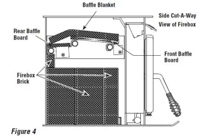

If the draft has changed it might be related to either the flue or the wood. Check the chimney cap screen for plugging. If the wood is not fully seasoned it can make the stove act sluggish and the fire will need a lot more air to burn. Another thing to check is to make sure that the insulation blanket on top of the baffle is properly in place and has not bunched up in the back near the flue exit. That can block draft.
Here's the location for the manual for the Striker insert:
(broken link removed)
  • [Hearth.com] Questions on my Country Striker 160 insert
Mine dose not have a Baffle Broad like this it has fire bricks. I am not sure if it was ment to have brinks or a baffle as that is the book I have and it is from the Lenex Country Stove not from when Country was making them. The top were the front baffle board in this view is not the same as mine. The two round things are and the same hight not the frount one lower then the back like it the cut-a-way you posted So I am not sure if someone just added bricks or if they were ment to be there.
The wood is the same as I have had all year. Split this fall be cut and down for a few years. The person I cut with is using the same wood in his Country Elite 260 and not having a proublem. The Chimney pipe and the top of the stove over the fire bricks had cloged up and I cleaned them all out yesterday so it is a clean shot out the pipe into the chimeny. So the only other air should be the air coming in from the bottem on the draft rod right?
