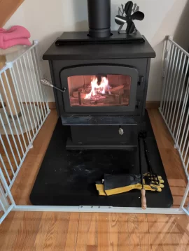

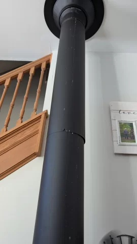

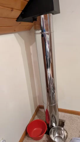

Good point. I don't have a picture of the whole stove pipe. It's a telescoping section hooked up to the ceiling round piece (forget the correct terminology).

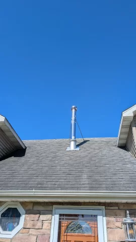

The round piece is called a chimney ceiling support bracket or something along those lines. Every company calls them a little different.
Your stove pipe is double walled straight up to chimney pipe at the ceiling of the first floor and straight up through the 2nd floor and out the roof. Looks like a support bracket there too?
The top of the chimney is at least 2 feet higher than anything within 10 feet? Specifically the roof ridgeline? A little hard to tell from the pic.

So yeah I went extra safe and put supports at the ceiling level and roof level since the roof support also made sure the proper distance was kept from combustibles. And yes I made sure to follow the rule 10-2-1? Or whatever it is. It's two feet higher than the ridge line.

Excellent on the chimney 12-2-3; well at 20-22 feet you're sporting a chimney with a really good draft. (most likely) add high winds and woosh! In your case, I would consider adding the flue damper as that will let you slow the draft down to a manageable level. If your building N/S on a reasonably good bed of coals, I would watch for the wood to start burning and then dialing it down from there. I have an old woodstove and If I'm not careful it will burn my entire re-load of wood in 2-3 hours. I do just what I just told you. Get the wood just burning and start shutting down the intake and the damper.
You might experience some dirty glass but every stove is different.

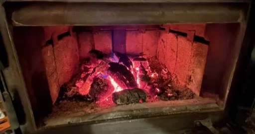

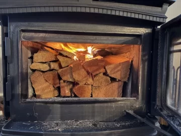

Here is this morning's fire. It's all softwood with a top down start. Normally I load thicker splits, but this is what was on the top of the pile. The second picture is the coal bed 10 hrs later.

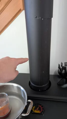

Can you install the damper in the exposed section of the inside pipe and still have room to slide the pipe to take apart or put together?

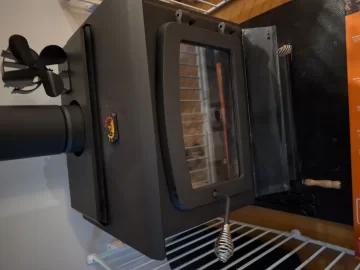

You mean in this section of the telescope? Yeah I would still have plenty of room. I wasn't sure if the damper has to go between the stove and the stove pipe.

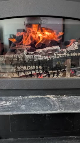

This is my first burn this morning. They usually go this way where the flames are usually at the top of the stove.

Pack it well. North South loading lets the boost and airwash air travel right down the length of the splits. E/W loading acts like a dam in front of this air supplying the fire.

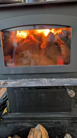

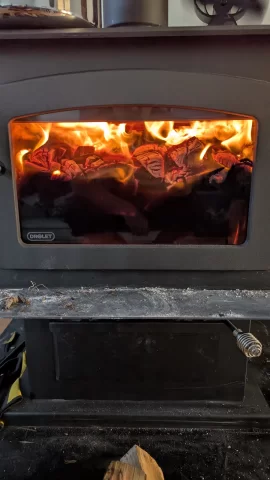

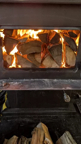

Second load of the day. Trying N/s. Couldn't find a short piece for that void. I immediately closed the air completely. Will update later
looks good from here! 😁 :ZZZ Check out this N/S load N/S Loading There are a lot of posts in that thread and it can be interesting! I read it every day
Thanks I'll check it out. Looks like the fire still has some pretty good velocity and I expect it to increase more. Definitely not going to get the lazy mesmerizing burn this way I think.
