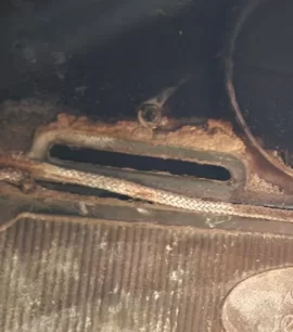

4. Correct gasket between the rear wall and baffle assembly
I also need to replace the gasket where the rear of the baffle assembly connects to the stove's rear secondary air inlet. This is the location shown in my ATTACHED PHOTO. The old gasket has already been disturbed during disassembly, so I would prefer to replace it before reassembly. According to the European Jøtul parts documentation, the relevant gasket appears to be 8.7 mm in diameter, LD (Low Density). I've also seen recommendations on this forum for a 3/8-inch (approximately 9.5 mm) soft gasket.
- Which gasket size is correct for an older European Jøtul F3 CB – 8.7 mm or 9.5 mm?
- Should it be a soft, round, low-density gasket rope?
- Is it acceptable to use a few small dots of high-temperature gasket adhesive or furnace cement to hold the rope in position during reassembly, with the final seal provided by compression? I want to make sure this connection is properly sealed without accidentally blocking the secondary air passage.

I'm not sure how the European F3CB differs from the US version but the easiest way to service the top of the baffle is to remove the top. It's held in place by an Allen screw on each side. Mark the rear of the top with tape first so that it goes back on the same way.
Low density 9.5 mm (3/8") gasket is for the stove top. The rear baffle gaskets (17 & 18) are 8.7mm LD.
