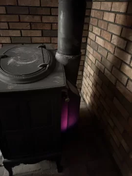

My house came with an old Jotul Firelight 12. I've been using it for the past 6 years with no issue. But last week, this happened:
  • After loading it up, I heard it “whooshing,” like air rushing up the stove pipe
  • It was running hot (around 650), but I had just closed the damper so I expected the temps to drop
  • But they didn’t…it hovered around 650. That’s when I noticed the back glowing (see pic)
  • I eventually quickly opened and closed the damper to disengage the catalyst, which seemed to work (or it started cooling off by coincidence)
  • One thing to note, the damper was really hard to close after opening it. Not sure if something was stuck or what. I was scared it was going to get stuck open which scared the hell out of me
Few things about my stove. It's old! The back plates has a small crack. But my chimney guy did inspect the stove when he cleaned the chimney and said I seemed good to go. Also worth nothing, this was my 3 or 4th load of the day when this happened, and it was probably my 5th fire of the season. Up until that last load...everything was a-okay!
SO...my question is, what do I do next? This feels pretty serious to me, but am I over thinking it? Do I need to have someone come out to inspect it, or can I do a sort of "common sense" inspection myself. This is new to me.
Thank you in advance for your help! Always appreciated.

Maybe the crack got bigger, allowing more air in and overfiring the stove
I would not use it like this until you figure out what went wrong.
I would not use A stove with a crack, not a sweep who says that it's fine when it's cracked
Do you have a flue thermometer? If so how high did that go up?

By back plate, do you mean the inner back plate or the actual back of the stove?
Did you hear any noise in the stove pipe or chimney? When was it last cleaned? How fully seasoned is the firewood? A chimney fire can cause an unusual suction and whoosh that can result in an overfire.
The stove should be allowed to cool down and thoroughly inspected. It wouldn't hurt to have the flue system inspected as well.
From the photo it looks like the back of the stove. Not familiar with that stove, but it looks like a catalytic chamber or something there?
Yes, that is the cat area. The design is somewhat similar to VCs and Harman cat stoves. It could be that too much smoke is getting past the cracked back in the wrong location or that the combustion package has broken down.

It was hovering around 650 degrees. I actually think the crack did get bigger. It was a hairline when I first noticed it.

  • Attached a pic of what I was calling the backplate. Maybe that's not the right name. But it's the plate in the back of the firebox.

It seems you have single wall pipe. At 650 that is too hot (internal would be 1300 ish)
The cracked backplate is not good. The stove needs attention. Failure to address these issues will just drive the stove into the ground and put you at greater risk.

@tg27, were you ever able to isolate the issue you had with the overheating? The cracked part in your pictures is the Rear Burnplate. They usually get cracked from one of two reasons. 1.) using the ash pan door to help start the fire by letting in air from the bottom. This is the most common reason. 2.) The cat cover is held in place by the Rear Burnplate, and if the cat cover is not in place correctly excess heat from the cat can crack and warp the Bernplate.
The crack in your burn plate is not the cause of your overheat issue and is not a serious issue. For those not familiar with the Firelight, the Rear Burnplate is an internal baffle ment to direct gasses from the top area of. the combustion chamber towards the cat entrance.
I'm very interested in your over heat issue and its cause. I've had my Firelight 30 years this fall, 29 winters with no major issues. I'd like to keep it that way.
I'm re placing a warped Inner Back Plate and a cracked and warped Rear Backplate due to a cat chamber cover that fell out of place the last time I replaced the Burnplate. The cat cover is a soft fiber material and after 30 years it didn't have the resiliency to stay in place while the Burnplate was installed. I have a replacement cover on order.
