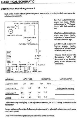

My J1000 does oscillate like you are describing. On my Jamestown J1000 there is a high fuel feed adjustment. My owners manual hints this is the same for yours. Here is a copy of that page. Don't be afraid to contact Jamestown. They have been very helpful in the past.

Thanks for the info...I talked to a tech at Jamestown today he thinks I may have a problem with my vacuum switch.He told me to bypass the switch and it did improve my feed rate.
Think I need a vacuum switch..$44.00.I did play with the high fuel feed adjustment a wee bit but it didn't seem to make a difference....didn't turn it very much?
