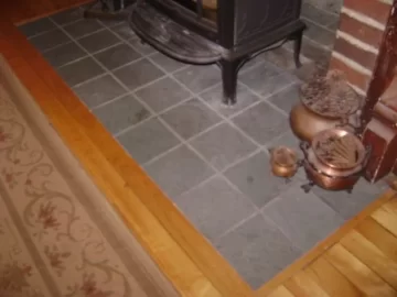

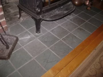

Here are 2 pics of mine. It is level with the floor. It needs spring cleaning of the ash around it.
Hey real nice job on that hearth! I'll let you know when the slate gets here and will supply cold beer of your choice...
