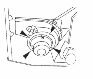

I'm late in my 2cents postings but will try to see if I can help.
I would start with having a clean stove as this is the issue of most stoves not working properly
As I can read from your post you did normal cleaning positures like heat exchanger cleaning and Ash removal.
The most important part like the big cleaning leaves a couple of questions open.
The integra has to be cleaned on the left side (Motorhousing - exhaust) as well on the right side.
Motor housing:
take the motor off and vacuum the pipes quite well and clean also the propeller of motor. Oiling is not needed as everthing is sealed.
see attached picture for illustration.
