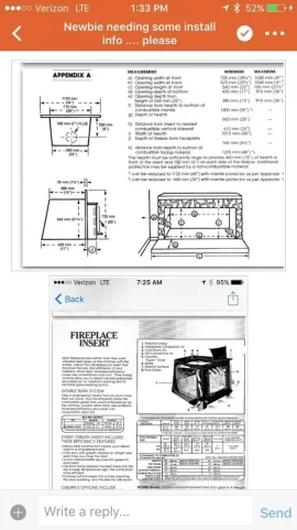

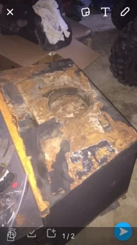

Here is the manual and a pic of the top of mine. [Hearth.com] 7" outlet to 10" liner question?!?!? Help please[Hearth.com] 7" outlet to 10" liner question?!?!? Help please
The cellphone shot of the manual is too tiny to read, but if this is the stove then it looks like you are right, that is 7" for this old insert. Can you provide the model number or manual url?
I'm sure it's still hard to see but under model it just says "Extended"
If you send me your email afraid I can forward you the manual from osburn

If it is a pdf, it should be postable. Does the manual have the model number information? If so, just a shot of that will do.
I see WH-3x414132xx , where an 'x' is an unreadable character. Maybe that's a serial number? According to their website, all inserts have a model starting with "OB", not "WH". I don't see anything like that on the plate, though.
Great, thanks for posting the pdf. This is a classic stove from the late 80s. As you've found out 7" is an odd size without a lot of suppliers or options. It may need to be made custom. The adapter must be made of stainless steel. This is more common in the UK. Perhaps one could be fabricated there?
