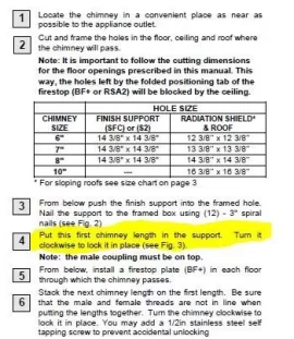

It's your house and you can do anything you want, including burn it down or asphyxiate the occupants. Though you might want to look at page 5 of Security's installation guide for SecureTemp ASHT+ pipe first.

Thanks for your diligence on my behalf. Be assured I will not cut the pipe. There is no male connector in the ceiling support which I removed from my install. This may be another feature of a truly crappy "professional" installation. The only support for the entire 38' of chimney was this support box in the basement, the firestops didn't cover the openings in the floor framing (6" spaces either side) and the pipe rested against framing in 2 places. All of these issues are being corrected according to specs. Forgive my persistence as it has led to the discovery of this connector problem with the support piece. This install was done over 5 years ago before I bought the house. I will call Security International Monday about the missing anchor piece and post.

As an update, I spoke to Securitiy Chimneys International this morning. Tech.
support says the screw into the support requirement was implemented in the last year or so and that it is ok to use the base support without the male coupler with the pipe end merely resting in place. Go figure. Don't worry, I still won't cut the pipe! Thanx for your help.
