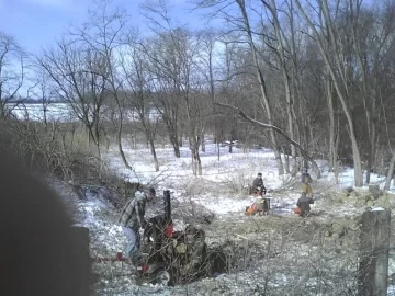

Yep yep! I like the 192t for de-limbing. The 361 guys bring it to the trunk and the 460 for the trunk. Thats a combo that looks like ants. Couple splitters going and your knocking down some cords.
  • [Hearth.com] needing upgrade
