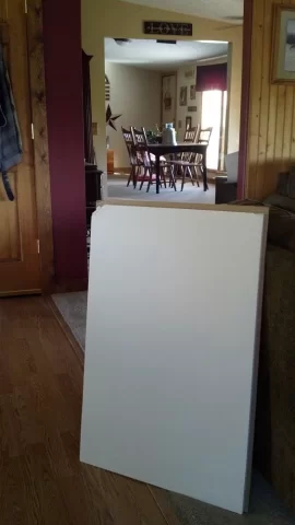

I bought a baffle board off of ebay 2 weeks ago, based on a thread from this Forum. I guess its not a strong or built as good as factory, so I can not reccommed it. Although I will say, that when my baffle boards break, I will try it. They are $60 a piece I need 2, so $`120) through ESW. This was $50 (thats with shipping and will do both boards with left-over) If you do a search, there are mant threads/topics on this..
