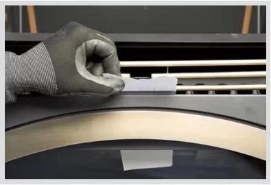

I was cleaning my stove today and decided to take a closer look at my door and how well it is sealed up.
I had read about the dollar bill test. So I checked it out.
Question: Should I be able to pull the dollar out?
About 1/4 of the seal there is little resistance, 1/2 had a little more resistance, and the other 1/4 I can't pull it out.
My stove is brand new and the seal looks new.
I checked to see if my door is adjustable but it is not
The stove has been burning fine. Not much to compare it to since I am new but no black buildup or lazy flame.
Ideas?
IMO your stove is fine. As long as it's burning well and relatively new I wouldn't worry about it. The gasket sounds fine, from what you posted.
As long as there is some resistance, then you should be fine.
Most stoves have some sort of adjustment though. Be it the hinges or the actual latch itself. Both of my Englanders (wood and pellet) dont have any adjustment either. Just push on the handle to make it tight. I would think the design would be different with the new generation of stoves..
If its burning good, with no lazy flame and your ash is not "black". Then I wouldnt worry to much about it.
Hello
This is what my Avalon Pellet Stove maintenance Manual states. So this is what the Manufacturer expects!
Door Seal: Yearly
WARNING: Make sure the heater has fully cooled (approximately 25 minutes) before opening the door and conducting service.
Air leaks into the firebox will decrease the stove’s performance greatly, leading to excessive sooting, inefficient burning, and perhaps a malfunction.
The door gasket must contact the entire perimeter of the door and create an air-tight seal. To verify this, open the door, hold a dollar bill against the body of the heater, close the door, and secure the latch. The dollar bill should be held firmly in place (check the entire perimeter of the door. If it is loose or falls out, the door must be adjusted
