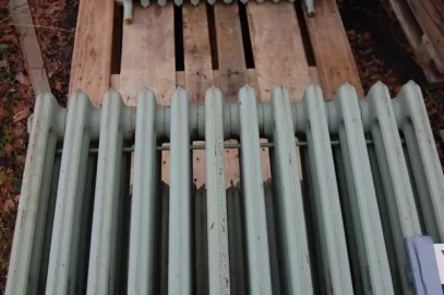

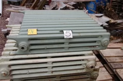

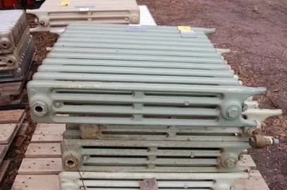

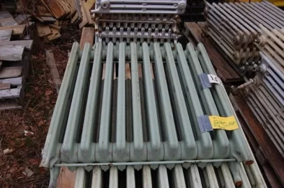

Could anyone tell me about these cast radiators?
They are 32"h X 28" W. 12 sections ,Tubes are 1-1/4" with 4 in each section.
They have connection top one end and bottom other.
Any idea steam or water?
Btu's at high and low temp?
What would be a fair price for to pay for each?
gg

Those can be used as steam or hot water. It the bottom/top configuration they would have been used for water so check them close for corrosion inside. You don't want to see piles of scale and rust in them.
They have an EDR rating of about 3-1/2 per section in four column configuration. At average water temperature of 170 they will emit about 150btu per sq ft @ indoor temp of 70*.
In other words if you had a rad with 10, 4 column sections and water temp of 170 you would get about 15,000 btu output of one of the nicest forms of heat known to man. :)
To give you an idea of output from low to high you would get about 50btu@120* water and 210btu @200*.
Price is determined by the condition of the rad, leak tested or not, local market and scrap metal price. New ones are ludicrous unless your last name is Gates or Buffet.
How does $60 sound? If I am patient they might be available for less, maybe $30.
They aren't pressure tested yet, I would have to do that and clean them.
I can feel some rust scale when I put my finger in the hole but I would guess that is normal once they are open to the elements.
