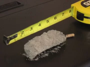

This is from a 10 or 12 hour burn of Lignetics, with my Versa-Grate disconnected.
Fire was normal, heat normal, but this clinker took up the whole bottom of the burn pot.
  • [Hearth.com] Super clinker

Impressive! Makes me want to run right out and go get some Lig's. I've forgotten what getting a clinker was like. ;-)
So that's what a clinker looks like! ;-)
You mean the Ligs? I have just a few bags left, then I'm moving on and not looking back at Lignetics. I'm getting some pellets next week; it remains to be seen what is available around here.
If you really want the Ligs, I'll stuff some in an envelope and mail them to you ;-P

10-12 HOURS!!! Yowzer's.... Thats pretty quick to build up that fast. Are these Green Label Ligs.. And if so. Are these the 100% Hardwood Green labels? Or the Blend Green Label? I haven't had any problem with them. Takes a few days, running straight, to get anything bigger than a 50 cent piece in the Quad. Most times there smaller than a nickel.
Thats a Super Large Clinker for a Super short amount of time. Why is the Versa Grate disconnected? Experimentation?

The gearbox for the Versa was getting bit noisy, so I figured I'd try running it without and see what happened. I will try again with another brand of pellet in the near future.
This is about 1 bag of pellets clinker. With the Versa going, I get much smaller clinkers, they are about 3/4" spheres.

That's nice! I haven't ever had to many issues with clinkers until this year. I bought a ton of Instant Heat from TSC and man have I gotten some HUGE clinkers! I almost have to call them clunkers because they are to big to make just a clink when they hit something!
What causes clinkers anyway?
I believe that clinkers are ash that has melted together into a semi-solid mass. I can't define it that well, but I know one when I see one!
It usually refers to the residue from burning coal, but we pelletheads have adopted the term.
Again, to much green raw material in the pellets.

Chlorides cause clinkers. It fuses with the ash and other minerals under high heat. Wood contain salts it leaches from the ground as its grown in. Along with the other minerals. The PFI label will have the allowable chloride content for a premium pellet. Green or not, If the wood has high chlorides and is pelletized, You then get what the OP has nicely take a picture for us to see. I have heard some mills will wash the wood to reduce the salt content. But I have only heard it as romurs. Nothing rock solid though.
Clinkers came from the corn burnes. Corn has high starches and it fuses with the other minerals in corn to form a lava rock. To reduce the clinkers corn burners will add ground oyster shells to offset them. FYI for you.
