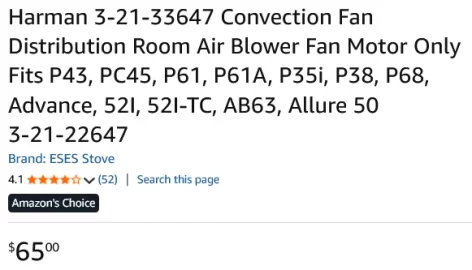

I tried to find just the motor for my Advance, not gonna happen. I ended up going with the fan motor combo from
amazon. Had to make a couple simple mods and straighten the squirrel cage and now it works great.
