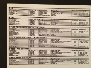

Don't know if it will help this is parts list I have for that Stove. Need SN to narrow it down.
  • [Hearth.com] Harman PF100 Distribution Blower Motor Replacement
