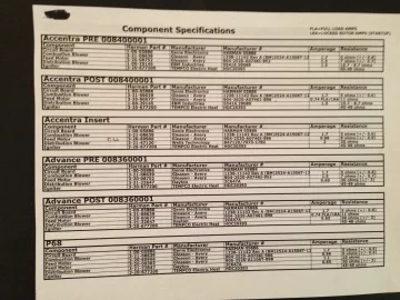

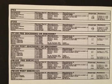

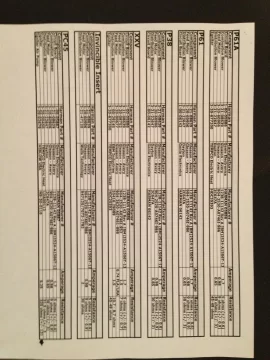

I need to replace the distribution blower motor on my Harman Advance. Anyone have the part number for just the motor alone and a good source. I know Grainger would stock it but I'm sure there are more economical sources out there, also some to avoid.
Thanks in advance,
Tim
I did a search and found this:
Supposedly someone took theirs out and read the nameplate:
see review by winelover.
The Harman PN will be in your manual, but if you can read the nameplate you may find the manufacturer.
Harmon Parts list I found here years ago.
