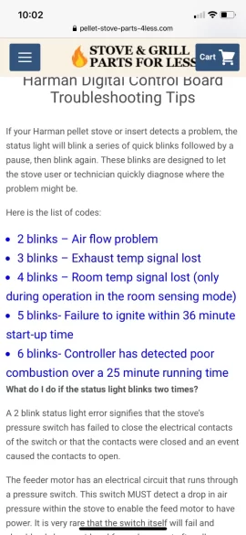

I am looking for some help- when I tried to start up my pellet stove for the season it will not go. There is a two blink status and the distribution blower and feed motor lights do not light up. I have cleaned everything that I can think of, checked the door seals, made sure the hopper lid is secured.

Check the fines cover to make sure it’s seated. Also air intake is clear and check the flapper on the intake to ensure full range of motion

Make sure you have it switched to auto, not manual.
