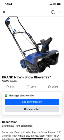

In the meantime time I found a newer SJ627E brand new in a box for $200 cash near me on Valentines Day so I scooped it up.
