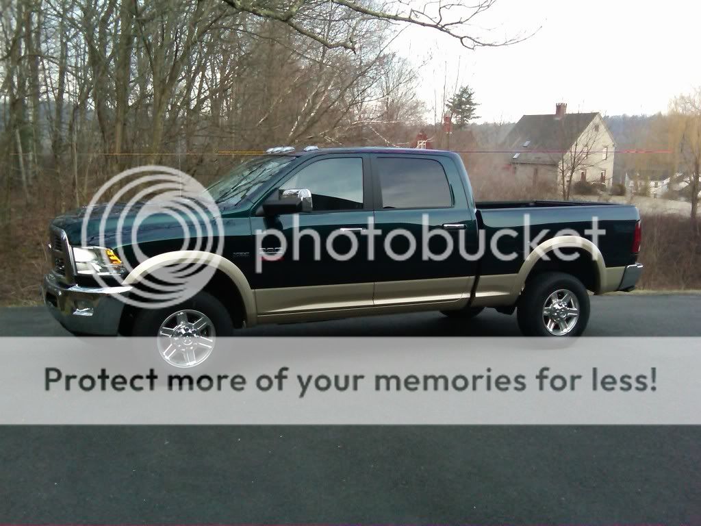

BTW - im a fellow ram 2500 Hemi owner. Show us what ya got!
[Hearth.com] Jotul Oslo Vs. Hearthstone Heritage.
Heres my truck. The picture on the right is factory suspension with 285 tires. Picture on the left is after I installed a Carli Suspension System. it's basically a 3" lift. Now I just need bigger tires.

Nice! Laramie, right?
I don't have a pic, but I have since attached some mopar 3 pad oval step bars.
They are fun trucks...and when that Hemi hits 5500rpm.....it's music!
A Laramie she is.
