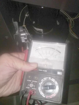

Hello
I checked the Hi Limit snap disc and it popped at 140 Deg F instead of 250 as etched in the front side!
Actually, I checked with Fasco and Inca Metals and they said the convection fan thermal overload circuit on the fan will trip at 110 Deg F and above.
If that happens then air will not circulate through the stove and the stove will get hotter, so the Hi Limit switch will shut the auger down at 250 deg F. This will happen very soon after the convection fan shuts down.
So after the stove cools to below 110 Deg F, the Fasco Blower thermal overload circuit will reset and the Hi Limit snap disc must be manually reset!
See pic of snap disc showing open circuit on the Ohm meter below!
