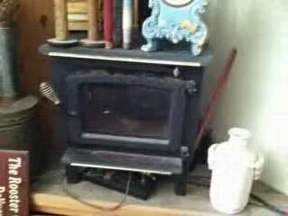

I live in East Texas and found this stove on Craigslist. I've asked for the brand and model number, but the person says the stove is to heavy and she can not move it to get that information. It does not come with a blower. She said she bought it from Lowes around 1996 and paid $400 to $500. Is this a good deal? Is it possible to add an after market blower. It will go in an area that has never had a fireplace/wood stove/heater.
21 inches deep, 24 inches wide, by 24 inches tall, firepot 12 inches deep, box opening 15 inches.............Wood burning stove barely used, has approximately 8ft of piping........$325.00.

Is that an older Englander with the gold trim work? Not positive, but it looks like it could be. $325 is probably not a bad deal.

That appears to be the small CFM stove like moderator fossil has in his workshop. 1996 would have been the year after CFM bought the plant and design from Majestic. A new one, now sold as Pleasant Hearth, is around $700.
I can't find specs, Bro. Is that the one that is around 1.8 - 2.0 cuft?
(and comparing pics - it sure does look like you are on it).

East Texas I would not think you get too much cold but still it does get cold from time to time. For sure it will depend upon your needs whether this is good for you or not. Still, I'd much rather have a stove that is too big than one too small. From what they paid, I'd say their asking price is just a tad high but not too much if it is in good condition. It sort of looks like a catch-all right now...or are they trying to hide something? Something like signs of an overburn? I am a bit mistrusting when it comes to used items.
She says it was bought to use when they were building the house. It was never installed in the house and is in the corner with pipe as a faux wood stove. They used piped through the window to heat while they hung drywall, paint, etc during the winter months.
The main problem I have with that little stove is that the baffle is welded in and so you can't take it out for cleaning or to replace it when it gets warped. At least the ones I have looked at up close were. You can search here on the forum for Century Hearth and find information from posters that own/owned the stoves. That is the name they were sold under from 1995 up until three or four years ago.
I believe the model number for that one was 244.
