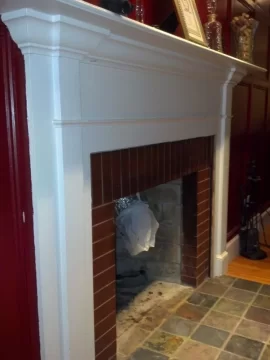

Photo as promised

OK Pete that's a first for me. I haven't seen another mantel like that. Is is all wood? The overhang looks like it is the same depth up for at least a foot. Therefore that is the mantel. I wouldn't call this wood trim.
There's a white painted frame around the firebox opening which clearly appears to be painted wood. There's a somewhat visible horizontal shelf on top which I assume to be painted wood. Then there's that whole brownish (taupe?) assembly between firebox & shelf that I've no idea what material I'm looking at. Need more info. Looks to me as though you've got some clearance issues...don't know yet whether or not a heat shield will solve them. Rick
Yes, it's confusing me too. Looks like it had a Photoshop airbrush treatment.
I guess i took a pretty bad picture, didn't realize the shadow was so bad. I've seen a few pictures on here that were pretty much identical to what i have. I'll post up some better pictures later today.
Until then, how do you define a mantle? Around the fireplace opening is the brick that you see. The rest of the trim/ mantle is white painted wood, and then theres the red wall.
looking at the fireplace, starting at the lintel and working your way up, there is about 7" of brick,the white wood projects out into the room one inch off the face of the brick. Do you consider that the mantle? The next horizontal line you see is just a piece of half round nailed to that same white board. Further up there is crown moulding helping to support what i thought was the mantle where it meets the red wall.

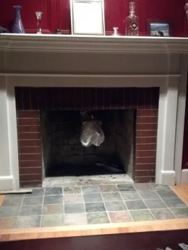

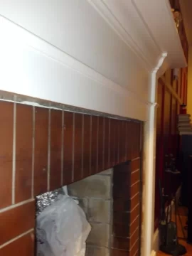

Here's some better shots, what do you guys think?

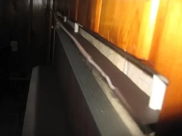

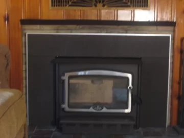

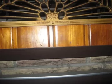

Im just posting pics of mine so you can see what I did , It is a HomeSaver Mantle heat shield that you can trim down to your needs good luck.
That's a complete different animal. Hard to believe this is the same mantel.This is more what I had visualized. I would take the shield out 1" past where the lower cove molding piece is on the mantel. That's where it's projecting out from the trim board.
etiger2007, thanks for those pictures, I think im going to just buy that heat shield
