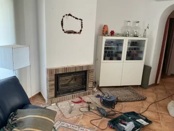

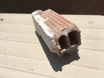

The enclosure is built with 7 cm hollow ceramic brick material (photo) with thin layers of mortar. The current insert is in there without any insulation.

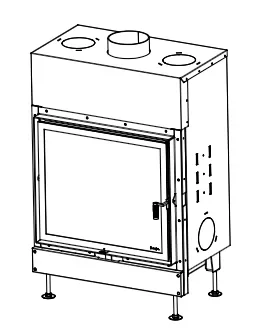

The new insert itself is a stove with a surrounding "convection mantle" around the fire box, so the fire does not directly heat the sides. Room air enters the mantle at the bottom, is heated mainly at the top in the heat exchanger, then heated air rises through pipes connected to the two openings at the top of the mantle back into the room (pic).
What do you think? Is an air gap of 1 cm between a device like this and ceramic blocks enough?
How would heat deteriorate ceramic blocks or the (thin) layer of mortar in between?

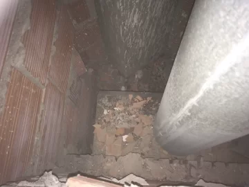

See 3rd photo, thats the inside of the enclosure.
