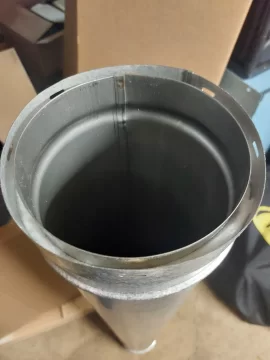

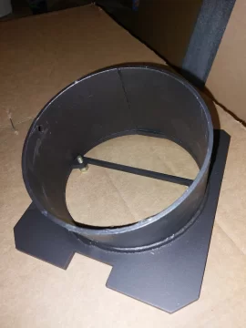

Begreen thanks for the info. I talked to Duraliner tech support and the flex pipe can mount directly to the stove collar. I received my parts and it fits. It's not real snug, but it does engage about 1.25" on the inside and out side of the male stove collar.
Does this assembly need the high temp stove pipe cement? If so, what do you recommend?
It depends on how snugly the connector fits. Can you wiggle the flex end a bit or does it feel firmly seated. If it's not a snug fit then sealing it with stove cement or gasket material is advised. If it's a pretty sloppy fit then an appliance adapter may be needed.
Yes it's loose and probably has about 1/16" clearance. Unfortunately, Duraliner does not have a straight coupler adapter. Only the 15, 30, and 45 degree elbows. I'll use a sealer. Which is better cement or gasket material? Is their a brand or part number you can recommend?
Thanks again for the help.

Gasket material can last longer, but it will need to be thin in this case and one needs to make sure it stays in place while seating the end of the flex. Furnace cement tends to flake off with the heating and cooling of the fitment but if a good slather coats the flue collar it may remain captive well enough.
