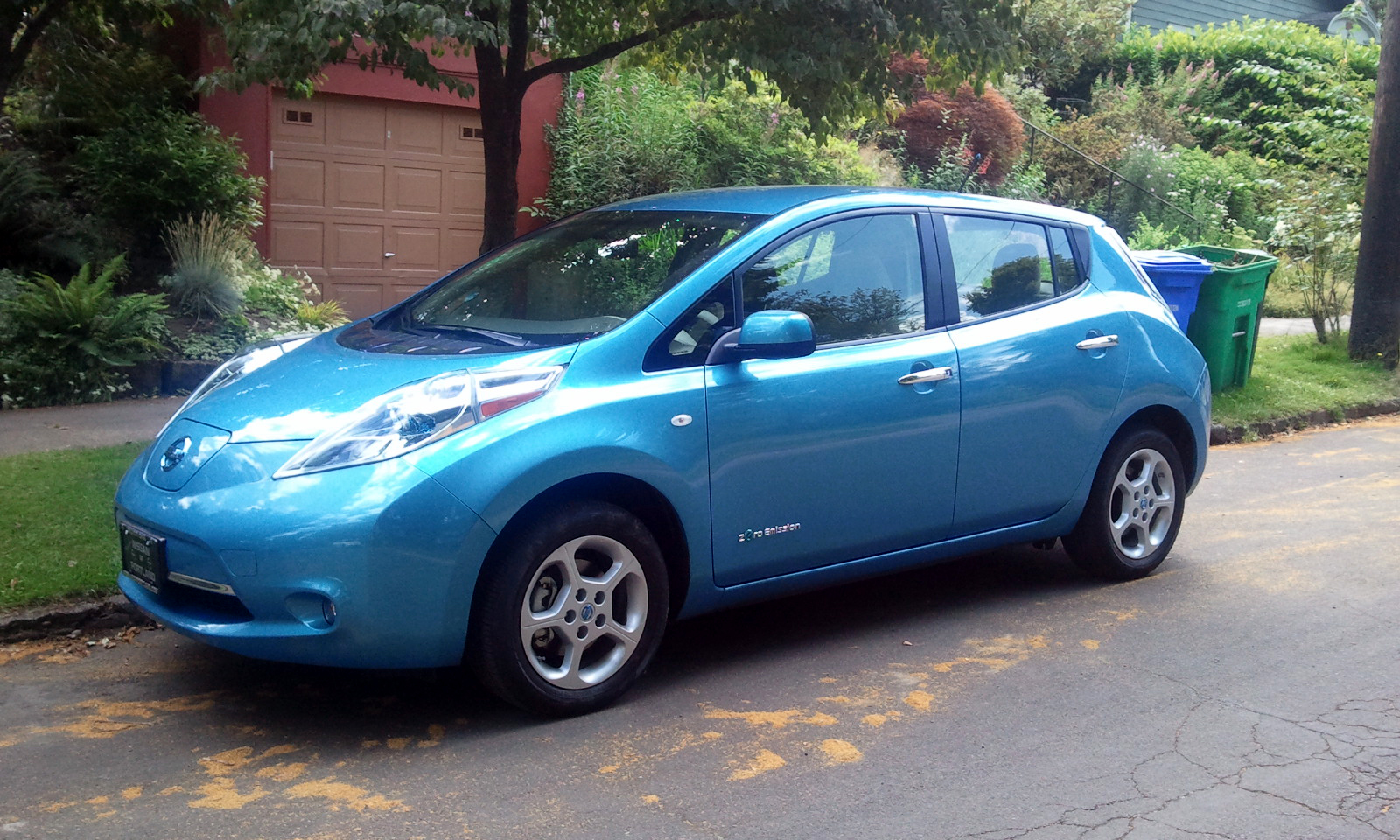

The wife and I commute in opposite directions, me into Philly on the train, her to the exurbs by car.
We have a new-ish Mazda5 microvan for family roadtrips, and an 11 yo high-mileage Camry, which was her previous commuter car, now retired to 'second car' status. Commuting in the Mazda is a gas-guzzler.
We just traded in the Camry for a Nissan Leaf lease. It will be her new commuter.
Looks like this:
[Hearth.com] a 2013 Leaf for the woodgeeks
Nissan's 'teaser' lease rate is $199/mo, $2k down, 3 years, 36k miles (about what she does commuting). With taxes and upgrades, we got out of there for $240/mo.
I ran a whole spreadsheet for this....the most attractive part is the >$5000 net savings in fuel costs over 36k miles, more than half the monthly cost. Factor in depreciation and anticipated repairs in the other cars, and the monthly cost of ownership is ~$60/mo.
And it should save ~21 tons of CO2 by 2017, run on 100% wind power coming in at $0.124/kWh.
Will provide user review later....
