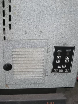

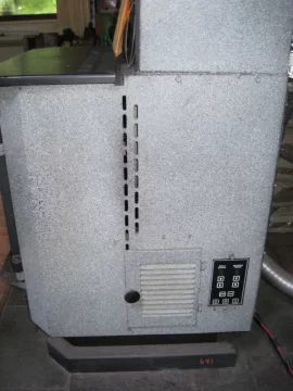

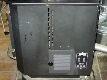

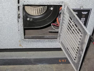

Also I am very much intrigued by your access door to the Convection blower, can you post a picture of it please? I know the exhaust blower on the back left side cleanout door come with the stove.
Thank You Don,

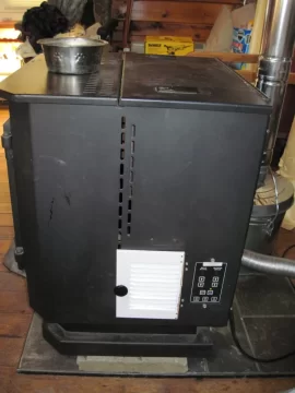

I snapped several quick shots of access door to the convection blower. The door itself I fabbed from a floor register cut in half from the local hardware store. So much easier than trying to snake the brush/vac underneath. The PDVC is actually a nice stove. Works great. I would say, long as anyone owning this stove, along with the PDV, keeps knocking the crust from the lower lip at auger, on somewhat of a regular basis during the season should be golden. I really like being able to operate the Heat & Convection blower separate from one another. Just thought, while I have the opportunity to try another stove would indeed do so, &, hopefully an upgrade.

Wow, that is so cool! You are now in our elite designer pellet stove club! Congrats on that innovative and practical design for easy maintenance. I really luv that! Thanks so much for those pics!
What did you use for hinges and how does the door stay closed?

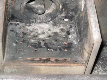

I've also discovered from time to time pellets unburned in the pot. What I've done an experiment at the time is to cut a pc of window screen as I had lots of. I folded a pc over placed just under the wear plate. This has eliminated pellets from not burning. After a fashion, perhaps once a year I need to replace the screen having finally burned thru. It really does last a long time, &, I don't find un-burned pellets dropping further down inside the burn-pot itself in front of the fresh air tube. I've also drilled every other hole in the wear plate slightly larger, for an extra-boost.. Snapshots just after 3-weeks use, for a general idea.
Sorry there Don, must have passed over your ?... The hinges I believe were sized / for jewelry boxes / medicine cabinet, been some time, not big at all. the knob is just a standard cabinet knob. I drilled a hole in the stove used the bolt & nut that came with the knob,, I just spin the knob on to keep closed & spin off during cleaning. As an after thought, was going to use two magnets, but, this works so well, never got around to try other.
Interesting about the burn pot.
What size did you drill the holes out too?
Holes drilled went with 1/4 inch. Have been thinking of trying 7/32 on the remaining holes, slightly larger than factory holes, but, don't want to hurt performance. It worked just great this last season, don't want to start going backwards with any mods. I had also saved the panel cut from side, thinking should it be too loud for others could always block once again.
Just for the hell of it, I also tried a Styrofoam cup fitted to the blower with the small end cut open, thinking, somewhat of a ram-air effect. The cup (large end) fit perfectly, unfortunately, performance went down. However, not shown in the older snapshot, have installed a pc of filter (taken from an old AC unit) fitted to both the door & blower which helps keep the dust-bunnies at bay.
The High Ash Burn pots that Enviro sells use 1/4” holes so they should be fine, I would not go any larger because then a whole pellet would fall right through. The only other suggestion I have on that is to make the 7/32” holes below the Igniter in the back right corner to keep the burn plate stronger in that area and you will see what I mean from what I am working on now. :-)

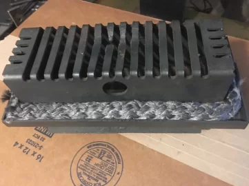

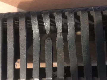

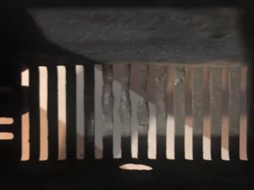

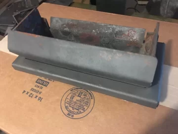

I am working on getting some equipment to fix this burnpot for a Saranac. The slats right below where the Igniter air comes thru have burned thru. See pics. So I ordered some 11 Guage perforated Steel with 1/4” holes. I am going to try to cut the bottom out with a Simadre 5200dx Plasma Cutter and weld in the perforated piece, The only issue I can see is that the Simadre does not have expanded mode like the Hypotherm 45 to keep the arc going when you go across a hole. So we are going to try putting a piece of aluminum flashing under the bars we are cutting to keep the arc going. Then if we can cut the new perforated Steel in the same manner. We can weld it on the bottom of the pot with my Vulcan MiG Welder. The new 11 Guage bottom should be stronger than the 12 Guage sides and last longer?
What do you think?

Sticking with the 1/4 for the largest holes.. 7/32 being ever so slightly smaller, not sure going to bother with the remaining factory holes (3/16), like I say, worked great as is. I failed to mention though, opened the igniter hole ever so slightly & with a taper/bevel. that too really helped the fire start much quicker. Your project, could always cut your perforated pc, then just lay inside the pot (over the old grate), should it work to your liking (testing) this season, come spring do a nice fitment / weld up. I like the welder.. Really enjoy my Lincoln-125/mig/argon. Anything too large a project, just take to the roundhouse.

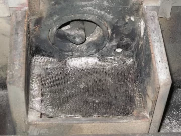

Having installed the screen under the wear-plate has prevented pellets from not burning completely. Drilling every other hole in the wear-plate has helped greatly, by allowing more fresh air to enter the hot coals. Drilling/Beveling the igniter hole, has allowed more air to reach its tip, &, heat to reach the pellets faster. My start-up routine takes less than 10mins to a nice roaring fire. Please-Note, I also use a thermostat as of last season, another test, result, I really can't see any difference alongside my preferred settings on the stove itself, from when the stat wasn't installed. My pellets NEWPs are stored outside on skids, covered year round, with roughly half ton inside the home any given time.
