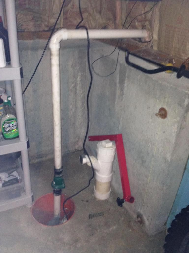

I have read a bunch of stuff on here, and it seems like I have one of the easier installs to do. I need to cut a round hole in a piece of plywood and the siding, and then run the pipe up and out. There is cement all around the stove. Please see the below picture of my sump pump. I was going to do the same thing with the stove.

On another subject looking at you picture. Do you have exposed foundation concrete walls in your basement? If so, it will suck the heat like no tomorrow without insulation. Just wanted to give you a heads up.

Tony,...................what you see is what I got. Exposed foundation for sure. Basement is not finished. Not expecting to heat the house here. Just want to be able to warm up my workshop / work out area.

My only other question at this time is this.................my wall thimble is too think. I have read posts about guys with the opposite problem due to walls being too think.
The wall where I am going to put the pipe is nothing more than one piece of plywood with vinyl siding on the outside. (See the above picture.)
The inside wall thimble plate will have nothing to fasten to. Do I need to make some kind of frame to fasten to the wall studs so that I can nail the inside wall thimble to it?

Making a simple box frame from a 2x4 should work to give the extra thickness and Support I would think and a cost of less than $3.

That's what I thinking Bioburner.
Support being a key component of the problem. Don't want things to fall and vent into house accidently.

My other question is about the "too long" thimble. I assume you will be installing a 5/8 sheet of sheetrock behind the stove location? If not, you should.
The stud walls should be fully insulated and a 4x4 piece of sheetrock should cover that to the cieling. The thimble is then mounted normally. The ceiling area over the vent pipe & stove should also get a piece of sheetrock secured. You need this to retain anything (like that paper backed insulation I see) from falling onto the vent or stove.
Last point: place the stove on 4" or 6" blocks, not on the concrete floor. One day your sump pump, or washing machine, or something watery is going to fail and those 4" are going to make your wife finally realize You Are A Genius. ::-)
