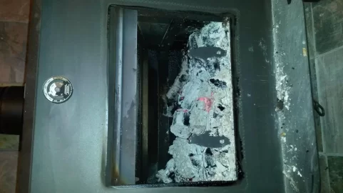

So last night I ran the IS hot for an hour or so before setting it for an overnight burn. I loaded an oak wood block that I split in half, and filled the rest with cherry.
I took the air control down to the 3rd notch which is just about closed. I went outside and verified there was no smoke. The temps at the hot spots settled in around 450 f an hour later. So I went to bed.
This morning I woke up not quite as warm as I prefer but the heat didn't kick on. I had the thermostat upstairs set at 69 f. It was in the mid 20's overnight. I have a 3 bedroom rancher with half of the house over the garage, new attic insulation, and insulated basement walls.
I went down and checked the stove. The firebox was black. I was seeing 275-300 f in the hot spots. So I opened the air. Sure enough as things lit up I saw that at least 75% of my fuel was still in there. Increasing the air raised the temps and I am back to a hot burn with plenty of burn time left. This was after a 9 hour burn.
Although I personally prefer a little more heat, this was doing the job of heating the house. I usually burn at #5 (air setting) and wake up to 72-75 degree temps with maybe 40% fuel load still in there.

Sorry the picture needs rotated.

A little more air would help. I like to see 550-600 when my quad is settled in. I was having issues with large coals left over in the morning until I started opening the rear air roughly 1/8 open. Now I have a perfect coal bed for reloads. Not sure if that is an option or not.

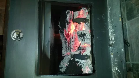

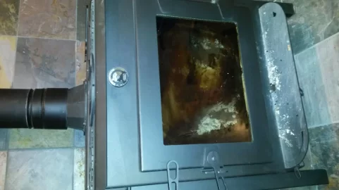

Your pic was with the door open, how dirty was the glass?
13 hours into my burn. The glass is dirty but not filthy. I can still see through it. The air has been at the 5th mark for the last 3 hours while I was at church. I came home and checked temps. The hot spot in front of the cat is about 275 f and the stove top is 200-250 f.
I opened the air and it lit up again. Sure enough there is still almost half a load of wood in there. I raked the wood front and I will let it run at half air and see what the temps do in the next hour. It is 43 outside and 71 inside.
I can't say anything bad about Quadra Fire. It is a really fantastic stove. This stove easily out performs the 4300 any day though. However, it is much larger and has a catalyst.

Wow......after 9 hours, you still have that much fuel in the firebox? Wow....... I have a small 1.9cu ft firebox, and a solid 4-5 hour burn is the norm, while maintaining about 400-425* on the stovetop.
