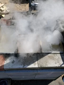

This season I did about 115-120 gallons of sap into 2.25 gallons of syrup of 10 red and 6 Norway maple trees. It was a terrible season for the reds so much less than I expected...80% Norway sap... but the syrup is very good.
This was the evaporator 2.0 that I upgraded halfway through the season. My first one was very rudimentary and while it drafted all, it allowed too much heat to escape. I redid the interior to include the firebrick and masonry brick I described above and configured the blocks to allow me to recess 3 buffet pans like you have there. I could easily handle 40 gallons a day if I started at 9 am...it just eats wood if I want to keep the boil rolling hard. I used about 3 full pickup loads of pallets. Shoveled a lot of nails out at the end!
Adding some "modern" stove tech like a take chimney, firebrick, and making it as airtight as possible so it would suck air in through the coals made all the difference. It burned much hotter on less wood and stayed hotter longer than my initial design. Next year I may add a baffle block 1-2 ft before the chimney as an experiment we'll see. Im not sure it needs it tbh. Also I think expanding the channel for the smoke to get into the chimney may help a little with the mess. Easier flow, less leakage into the blocks and pans. Lots to experiment with and improve.
