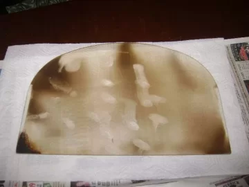

I had a bad glass gasket that I repalced recently, and it made a difference.

Hi Ray,
The gasket was a small self-stick one that sits in a shallow channel. Easy change out. I read a post on hazy glass and it got me thinking. Sure enough, I could move the glass in the door without much effort.
Here is what it looked like. You can clearly see what points the air entered.

Wow Jon you had lots of leaks! I have 2 leaks with one being worse than the other.. I need to find the black/graphite colored gasket for this stove..
