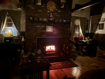

I have the Drolet 1800i and it has a good viewing window. Heats well too.
  • [Hearth.com] Finding a new insert
