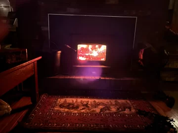

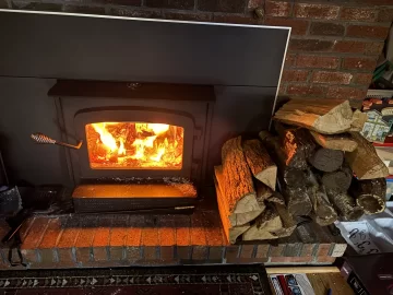

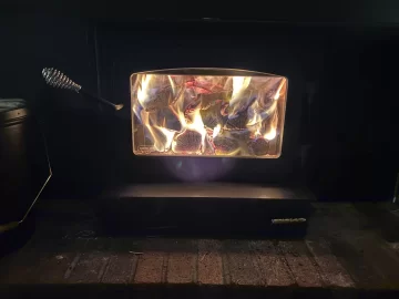

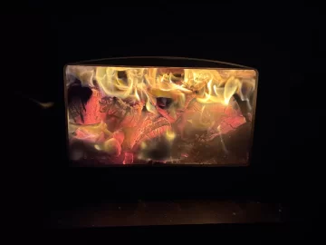

Drolet 1800i. I like mine so far. Will be the 2nd full winter I’ll be using it this year, 2 and a half winters total.
  • [Hearth.com] Wood burning insert - where to start?
