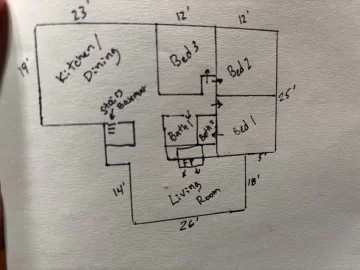

The Summit will run ok on a partial load during mild weather. Post a quick sketch of the floorplan so that we can see how well the heat will convect? Include the fireplace and the location of the stairwell if there is a second floor.

FP is fireplace. Not totally to scale. Its a single story home with a nearly full basement.
Super, that's helpful. The floorplan wasn't designed for wood heat. It looks like the best bet for more even heat in the house would be to put a table or box fan in the kitchen/dinig area, placed on the floor, pointing toward the living room. Run it on low speed. It will blow the cooler air down low, toward the woodstove. The denser cool air will be replaced with lighter warm air from the stove room. Running this way you should notice at least a 5F increase in the kitchen temp after about 30 minutes running. This will also help keep the LR from overheating.

The Super would work, especially if the intent is to fire up the Hitzer in the very cold weather.
