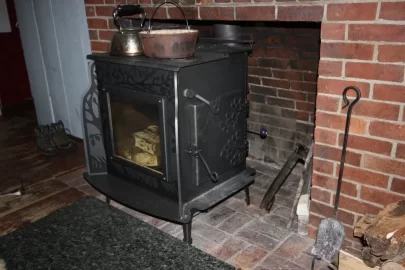

[Hearth.com] Absolute Steel beta testing... my first cat
Hey, that stove don't look half bad. >>
I didn't realize there was some artwork on the load door too. I like that perspective - most shots are head on. It shows how the profile is very tall. Still trying to picture a stove with that view without the wings. I think the wingless ones also have no lip under the glass?
