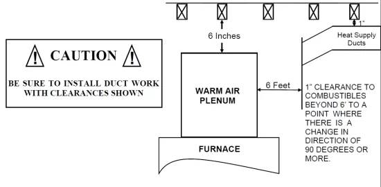

This is not necessarily true. Your local code/your appliance may vary, but many wood furnace manufacturers simply specify that 250 degree rated flex must be used, and that it must only be used for runs between the main trunk line and the room registers. Below is the language that Englander uses:
NOTE: The warm air supply-duct system should be constructed of materials with a minimum temperature rating of 250 deg. F. Also, the plenums installed to the furnaces are to be constructed of metal.
My Englander is ducted into the rear of my oil furnace plenum. The main trunk (8x14 sheet metal) exits the opposite side of the plenum with the first flex duct line located about 6' from the plenum. My local inspector (who is also a volunteer firefighter) signed off on the install as did my homeowner's insurance company. That said, I needed to install the flex because I had done some remodeling and moved some registers around, so I sourced brand new flex duct with a proper temperature rating. Flex that was installed 20 years ago may not be adequate for wood furnace service. Furthermore, again, the OP's locale may vary, but 1" clearance from combustibles is usually all that's required for ductwork connected to a wood burning appliance, and only for the first 6' from the appliance. My main trunk line was already dropped 1" from the joists-my inspector told me that this was because an oil/gas furnace is perfectly capable of overheating as well and therefore the clearance is needed anyway, so the existing ductwork may be just fine.
Nope, 6" for the first 6', then 1" after...here is a screen shot of the duct clearance page out of my Yukon manual. This is standard wood furnace duct clearances right from NFPA code
I think I see the disconnect here. The Englander hot air outlet fits 8" round duct. I have about 7' of 8" round duct which carries the hot air to the plenum on top of my oil furnace. That satisfies the 6'/6" requirement. Many add-ons (Englander, Hotblast, etc...) are configured in this way. The Yukon is not an add on, it's a combo and is configured differently. That said I was wrong in the way I phrased what I said-I was referring to the existing ductwork in the home.
