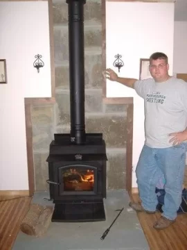

I also use a Rutland thermometer on the step up and it is quite usual to see temps of 600F+, I start to turn things down when the secondarys kick in right around 600.
The pic was a few days after I installed it.
