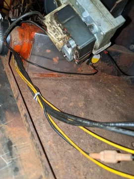

Can you post a pic on what you did you cover that round hole on side of the air intake and what else you did as there's just a slit on the bottom on the air box
Sure, it's not pretty though. Haha. Just bent up a piece of aluminum sheet metal I had laying around. I used RTV to affix (clamped it until it was dry) then ran ran some RTV around the seems. As for that blocker plate, I used some pliers and a grinder to remove the spot welds and then the plate. I also didn't take great pictures when I did it, sorry.
View attachment 288561 View attachment 288562
Did you cut a hole in your fireplace?, I really need to do this!! also the blocker plate do you mean this plate circled inside the hole area?, where did you buy your flex hose?
