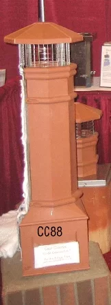

Here is another option for you.
I had a business making chimney extensions - but sold it. I have some samples left over at a very good price.
They are two-piece cast aluminum and you run your flex or rigid right up through them and wrap it. It gives you a great chimney pot look too!
The CC88 sells for $395+, but $125 plus shipping takes one of these samples!
It's the one on the left in this booth pic.
