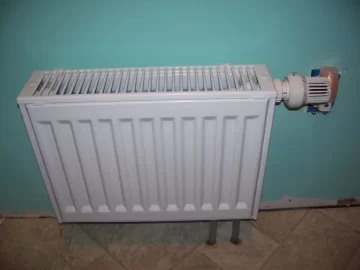

Send me some pictures.

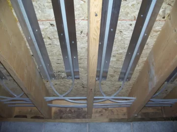

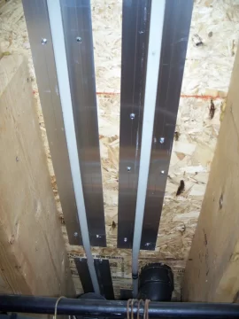

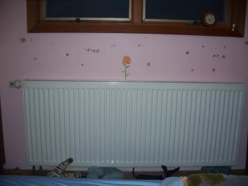

Had a chance to take one of the radiator in the girls' bedroom.
Added one of the small rad in the bathroom (someday I'll finish the trim and cover plates).
Also added a couple of the retrofit underfloor. In one of the pictures you can see the Thermofin panel angled to go around the soil pipe.
ETA, this was Buderus brand, but it looks awefully similar, including model number and size to the fraction of an inch of the one that you posted. I'm not sure who manufactured it, but I think this panel is sold under several different brand names.

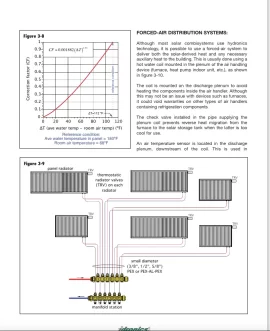

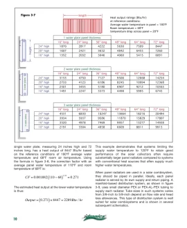

Here is a cheat sheet to show output change at different temperatures. From Caleffi idronics 6, google that if you need more info. Built around the Dianorm but they are all very similar in construction and output tables. Easily found in the US Dianorm, Pensotti, Buderus, Rental, Myson. Steer clear of imports from PRC

Correct, keep in mind that graph is used with average water temperature, not the supply. So if you are supplying 160 with a 20° temperature drop you have an average of 150.
Using that graph above 150- 70 air temperature = 80. Run up to a .65 multiplier. Take the radiator out put from the sheet times .65 and see what the output will be at reduced temperature.
Remember also if you put multiple radiators in series, you have a temperature drop at every one, the last in line seeing much lower temperature. Generally 2 maybe 3 small rads in series.
It's all about the surface area, which is why radiant floors or ceilings running 90 temperatures need to cover the entire square footage of the room.
The plus with panel rads is the output is radiant and convection, so they do move some heat via air currents.

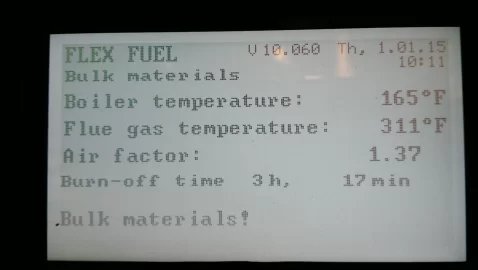

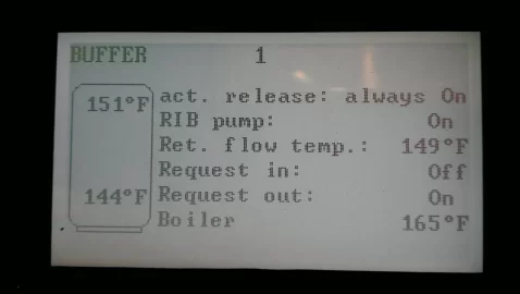

This was with my tanks starting out at 111°. Flue temps were consistent. This zone is the shortest. It's right above the boiler room. I'll do the panel rads and eventually pipe in some underfloor radiant as well. I measured again. I have a 22', 10' and 4' section of conventional baseboard. Replace the 22' with 20' of panel rads. Get rid of the 4' and replace the 10' with another 10'. That increases the btu output to 32,700 btus@ 180° then downward based on your previous calc. The water is being pushed by a big pump, taco 2400-20.
